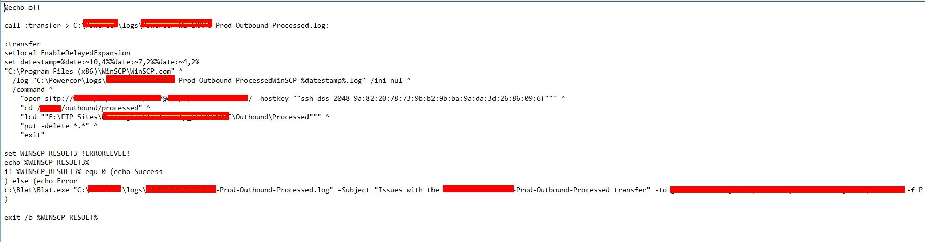

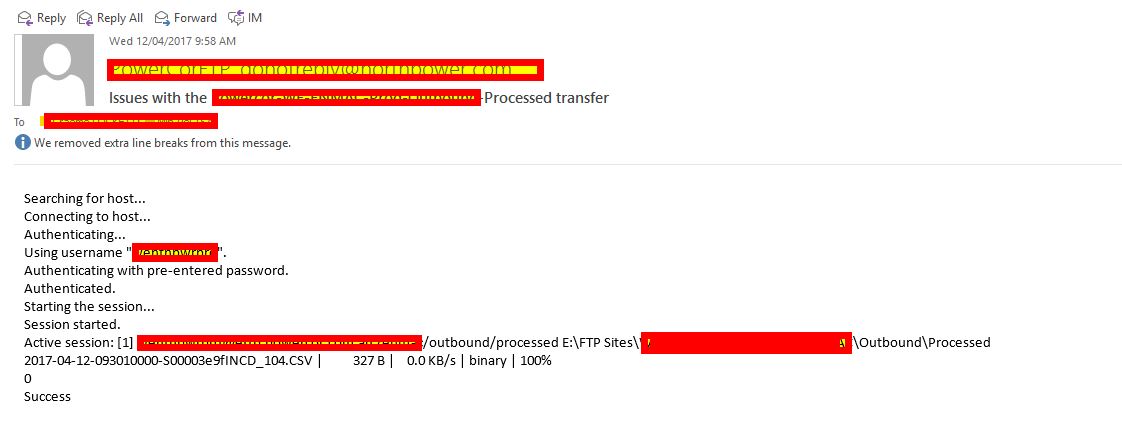

Re: %WINSCP_RESULT%
Hi Martin,
I hear what you saying and yes it is a batch related issue. I just understand how the script gets a result of 0 and still sends the email.
I use the call feature because it creates the perfect log file of what would be seen on the screen if you run the winscp task manually
I have attached an image of the script and also the Email generated. Note: that the email shows "Success" and also the value of WINSCP_RESULT [0]. So in theory the email should not have been sent.
43,071
Re: %WINSCP_RESULT%
The problem is that the script actually runs twice.
First, the primary script instance call a secondary instance (with redirection). Once the secondary instance finishes, the call returns and the primary instance continues with the same task. Just try to run the batch file manually. You will see WinSCP output, despite a seeming redirection. Because only the secondary instance is redirected. The primary instance is not.
If the primary (non-redirected) instance fails, it will send successful log of the previous (redirected) secondary instance.
You should add exit after the call.
