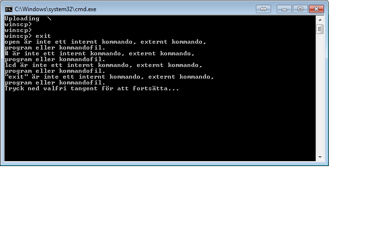

Hi
Sorry for the long delay.
Actually when I run the bat file or just opens winscp and displays the winscp> prompt
Nothing more happens, until I wrote exit, and then the bat file continued and displayed error messages for the rest of the command in your line...
Open is not an internal, external or program ... So the commands are not transferred into winscp
Attaching screenshot (Swedish)

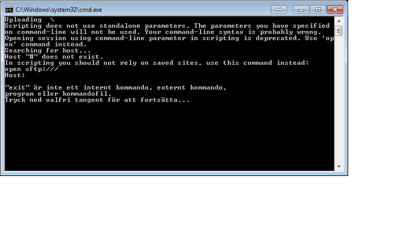

Jobe
4
[Black bOx in the wall]
Update:. Somehow the texteditor added carrier return.
However a new error had occurred, see screenshots
