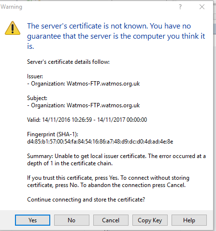

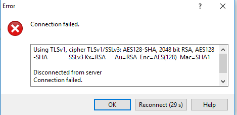

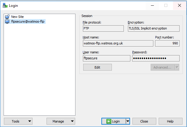

WinSCP Will not connect to my FTP site. My config is displayed in Appendix 1 then when I press login I get the screen in Appendix 2. I then click yes and get the screen as in Appendix 3.
I am using a self signed certificate to which I updated and cannot connect on.

. 2016-11-15 09:21:54.441 Session name: ftpsecure@watmos-ftp (Site)
. 2016-11-15 09:21:54.441 Host name: watmos-ftp.watmos.org.uk (Port: 990)
. 2016-11-15 09:21:54.441 User name: ftpsecure (Password: Yes, Key file: No)
. 2016-11-15 09:21:54.441 Transfer Protocol: FTP
. 2016-11-15 09:21:54.441 Ping type: Dummy, Ping interval: 30 sec; Timeout: 15 sec
. 2016-11-15 09:21:54.441 Disable Nagle: No
. 2016-11-15 09:21:54.441 Proxy: None
. 2016-11-15 09:21:54.441 Send buffer: 262144
. 2016-11-15 09:21:54.441 UTF: Auto
. 2016-11-15 09:21:54.441 FTPS: Implicit TLS/SSL [Client certificate: No]
. 2016-11-15 09:21:54.441 FTP: Passive: Yes [Force IP: Auto]; MLSD: Auto [List all: Auto]; HOST: Auto
. 2016-11-15 09:21:54.441 Session reuse: Yes
. 2016-11-15 09:21:54.441 TLS/SSL versions: TLSv1.0-TLSv1.2
. 2016-11-15 09:21:54.441 Local directory: default, Remote directory: home, Update: Yes, Cache: Yes
. 2016-11-15 09:21:54.441 Cache directory changes: Yes, Permanent: Yes
. 2016-11-15 09:21:54.441 Recycle bin: Delete to: No, Overwritten to: No, Bin path:
. 2016-11-15 09:21:54.441 Timezone offset: 0h 0m

. 2016-11-15 09:21:54.557 Verifying certificate for "" with fingerprint d4:85:b1:57:00:54:fa:84:54:16:86:a7:48:d9:dc:d0:4d:ad:4e:8e and 20 failures
. 2016-11-15 09:21:54.557 Certificate common name "Watmos-FTP.watmos.org.uk" matches hostname
. 2016-11-15 09:21:54.557 Certificate for "" matches cached fingerprint and failures

< 2016-11-15 09:21:54.588 530 Valid hostname is expected.
. 2016-11-15 09:21:54.588 Connection failed.
* 2016-11-15 09:21:54.626 (EFatal) Connection failed.
* 2016-11-15 09:21:54.626 Authentication failed.
* 2016-11-15 09:21:54.626 Using TLSv1, cipher TLSv1/SSLv3: AES128-SHA, 2048 bit RSA, AES128-SHA SSLv3 Kx=RSA Au=RSA Enc=AES(128) Mac=SHA1
* 2016-11-15 09:21:54.626 Connection failed.
* 2016-11-15 09:21:54.626 Valid hostname is expected.
