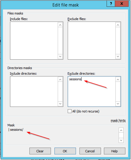

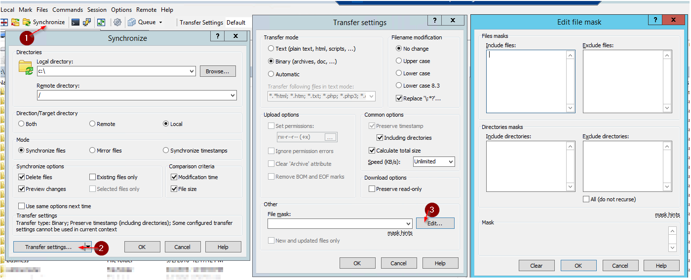

No, I do not unfortunately. The code I sent should work. You can use the GUI to build a filemask and that's what I did for you in my example. I'm not sure why it's still syncing the sessions folder. Also, */ means to not sync any subfolders so you don't want that.

I use the mask tool you point to create this:
-filemask=""*.*; *.*/|/sessions/""

You were right again. If I just place the exclusion, on the GUI version (| sessions/), works exactly the way I need.
