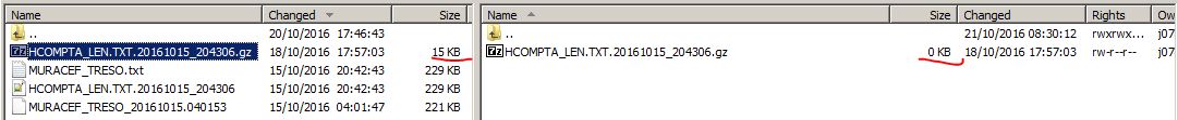

I'm using WinSCP V5.9.1 (Build 6885), when I copy a file, the destination is 0 byte, you can see the screenshot and log in attachment, here is the log too :

Thanks :)

As you can see in the log, the server did not return any error. So WinSCP could not know that anything (let alone what) went wrong.
