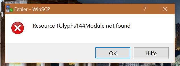

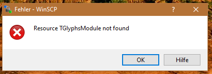

Raziel
Raziel wrote:
So did you try the latest WinSCP 5.10.x beta?
Yes, check attachments.
Check attachments.
I need to relog/restart to get rid of this.
43,071
Raziel wrote:
Check attachments.
I looks like you have copied the winscp.exe from WinSCP 5.10.x portable package to WinSCP 5.9.x installation folder manually. Please use an installer for the WinSCP 5.10.
