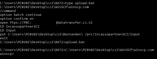

OK, assuming your batch file is called upload.bat:
Open console (cmd.exe) and type:
type upload.bat
upload.bat
And post a screenshot of the result.

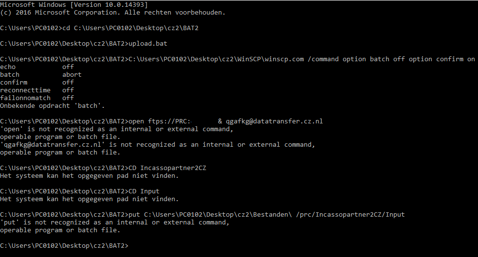

You have this:
C:\Users\PC0102\Desktop\cz2\WinSCP\winscp.com ^
/command ^
option batch off ^
option confirm on ^
open ftps://*:*@datatransfer.cz.nl ^
CD Incassopartner2CZ ^
CD Input ^
put C:\Users\PC0102\Desktop\cz2\Bestanden\ /prc/Incassopartner2CZ/Input ^
And I've asked you to do this:
    /command ^
        "option batch off" ^
        "option confirm on" ^
        "open ftps://*:*@datatransfer.cz.nl" ^
        "CD Incassopartner2CZ" ^
        "CD Input" ^
        "put C:\Users\PC0102\Desktop\cz2\Bestanden\ /prc/Incassopartner2CZ/Input" ^
        "exit"
You are missing the indentation (leading spaces), double-quotes around commands and the exit command.
And on many lines, you have spaces after the ^. That's not allowed. The ^ must be the very last character on the line.
See Why are some WinSCP scripting commands specified in a batch file not executed/failing?
