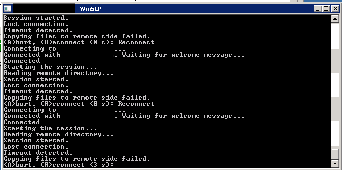

I have a script which uploads files to an FTP server.
Sometimes the server is flaky and the upload doesn't work. I can't change that (it's not my server) and I can accept if the upload fails. However, for some reason WinSCP tries to reconnect to the server instead of aborting.
I would like to abort this reconnection automatically or after some time so I know this has failed. Now winscp is just retrying this endlessly. Because I'm waiting on the result everything else is waiting until someone comes along and chooses abort.
This is how the script is started:
winscp.exe /console /timeout=60 /xmllog="mylogfile.xml" /script="myscript.script"
This is the contents of the script file:
option batch abort
option confirm off
open -passive=on FTP://user:password@ftpserver
option transfer binary
option batch abort
option confirm off
put -delete "C:\directory\myfile" "/remotedirectory/"
exit
Attached a screen shot to show what is happening on the screen.
I had assumed that the "option batch abort" would choose automatically for the abort option, but it chooses reconnect instead. Am I missing some setting or is there some way to abort these retries?

It happened again. I used the latest release and the reconnecttime option.
WinSCP also keeps looping with the "trying to reconnect" prompt. It does not adhere to the reconnecttime timeout and is also does not adhere to the abort option.
I found a way to simulate this and that is to have an FTP server which only allows passive connections. When you try this without the passive option in WinSCP you get the same behaviour. Unfortuntaly I don't have my own FTP server so I can not give an account/password for you to try.
Is there some other way to get WinSCP to abort this endless retrying? Or is this a bug that has to be fixed?
