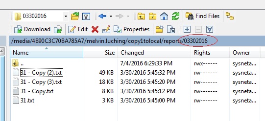

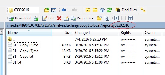

Hi Sir,
I Cant copy the file inside the folder of the date I input this is the script I used:
get -filemask="*>=%car%<=%car% 23:59:59" /media/4B90C3C70BA785A7/melvin.luching/copy1tolocal/reports/%car% C:\SMARTVISTA\%car%\reports
the filename format of the folder is 03302016 but the date format need to Input in my script is YYYY-MM-DD format, when I try to change that to MMDDYYYY I can copy the folder but the file created in the input date didn't copy.
I uploaded the picture of the directory of my ftp server thanks,
Melvin.
