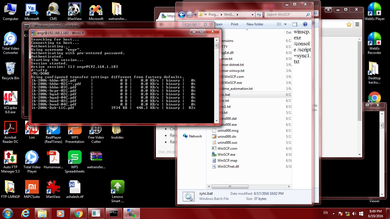

I had manually execute the command.. And it shows Following Error...
Plz help..
/m1/done
winscp> lcd d:/sftp
d:\sftp
winscp> get *.pdf
Using configured transfer settings different from factory defaults.
lk-2406-hwad-02c.pdf | 0 B | 0.0 KB/s | binary | 0%
lk-2406-hwad-03c.pdf | 0 B | 0.0 KB/s | binary | 0%
lk-2406-hwad-04c.pdf | 0 B | 0.0 KB/s | binary | 0%
lk-2406-tx1-01c.pdf | 0 B | 0.0 KB/s | binary | 0%
lk-2406-tx1-03c.pdf | 0 B | 0.0 KB/s | binary | 0%
lk-2406-TX1-04C.pdf | 0 B | 0.0 KB/s | binary | 0%
lk-2406-TX1-05C.pdf | 0 B | 0.0 KB/s | binary | 0%
lk-2406-tx1-06c.pdf | 0 B | 0.0 KB/s | binary | 0%
lk-2406-TX1-07C.pdf | 0 B | 0.0 KB/s | binary | 0%
lk-2406-tx1-08c-.pdf | 0 B | 0.0 KB/s | binary | 0%
lk-2406-TX1-08C.pdf | 0 B | 0.0 KB/s | binary | 0%
lk-2406-tx1-09c.pdf | 0 B | 0.0 KB/s | binary | 0%
lk-2406-tx1-10c-.pdf | 0 B | 0.0 KB/s | binary | 0%
lk-2406-TX1-10C.pdf | 0 B | 0.0 KB/s | binary | 0%
lk-2406-TX1-10Cnew.pdf | 0 B | 0.0 KB/s | binary | 0%
lk-2406-tx1-11c-.pdf | 0 B | 0.0 KB/s | binary | 0%
lk-2406-TX1-11C.pdf | 0 B | 0.0 KB/s | binary | 0%
lk-2406-tx1-12c-.pdf | 0 B | 0.0 KB/s | binary | 0%
lk-2406-TX1-12C.pdf | 0 B | 0.0 KB/s | binary | 0%
lt-2406-dak-01C.pdf | 0 B | 0.0 KB/s | binary | 0%
lt-2406-dak-03C.pdf | 0 B | 0.0 KB/s | binary | 0%
lt-2406-dak-10C.pdf | 0 B | 0.0 KB/s | binary | 0%
lt-2406-dak-12C.pdf | 0 B | 0.0 KB/s | binary | 0%
winscp> mv *.pdf 2406/*
Error moving file 'lk-2406-hwad-02c.pdf' to '2406/lk-2406-hwad-02c.pdf'.
File already exists.
Error code: 11
Error message from server (en): File already exists.
(A)bort, (R)etry, (S)kip, Ski(p) all:
