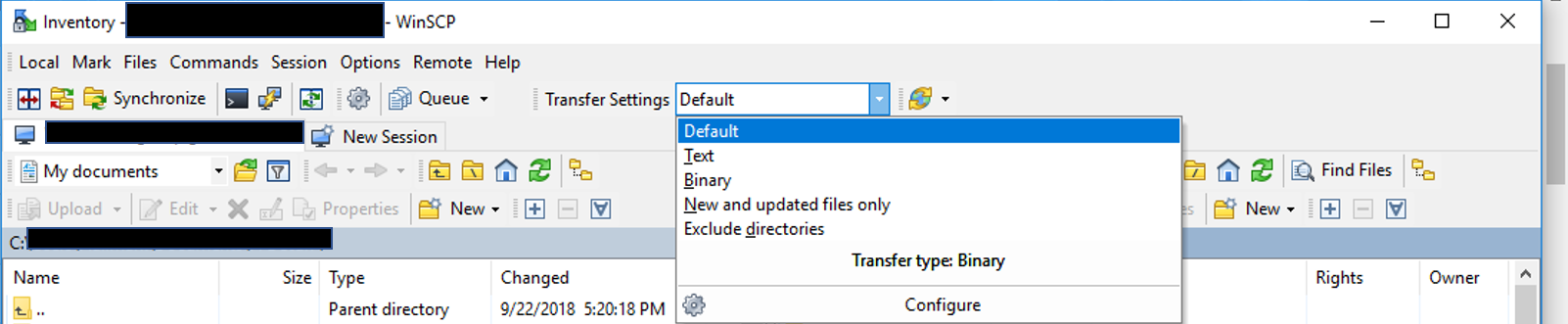

I see the same screen on version 5.13.3 and cannot locate the option to Generate Code in the Transfer Options screen. Is there something that I am doing wrong?

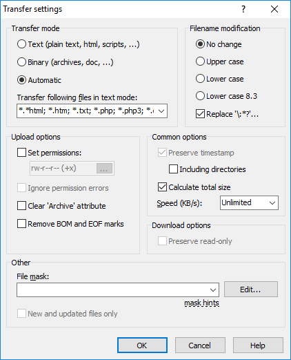

Transfer Settings and code generations
Hi Martin:
Thanks for your response. Your tool has some wonderful capabilities.
I actually clicked the Transfer Settings button. I am still not able to find the option to generate code based on the actions I am taken.
I am definitely missing something. Let me know if there is some setting I am not seeing.
Thanks!
Dave
WMF
I have the same issue with generating code using the Transfer Settings menu, I am unable to find the Generate Code option. I am using version 5.13.4.
@martin: The dialog linked in your post also doesn't have a Generate Code option. It does have a button to open the Transfer Settings dialog, which is the one I noted that also doesn't have such an option.

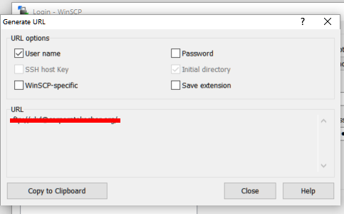

For the others also struggling to locate this feature, I was able to figure out how to at least get a template to work from. Not quite as easy as the implied feature that a specific action can be generated to code, but pretty dang easy and more than enough to work with to avoid this unproductive documentation loop.
In the Commander view, go to "Session" > "Generate Session URL code" > "Script" tab, then select the type of template you're after (script, batch, command line). You will just need to edit in the specific commands you wish to execute (as illustrated in the template by "Your command 1" and "Your command 2") which are well documented to be able to create by hand without the convenience of recording them from an actual UI action.

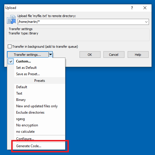

42,771
See attached screenshot below.
That path is clearly documented as well:
To open the dialog to generate the session URL or code, use:
  • Session > Generate Session URL/Code command on the main window to generate session URL or code template for the current session. (preferred)
At the very beginning of the article:
https://winscp.net/eng/docs/ui_generateurl
Simple step-by-step instructions are also here:
https://winscp.net/eng/docs/guide_automation#generating

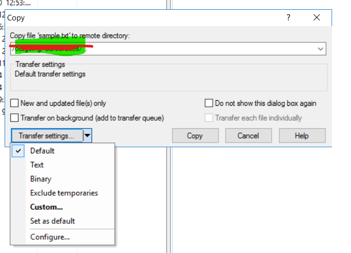

Re: I Also Can't Find Generate Code in Transfer Settings Dialogue
@ourbob1: As mentioned above, you need at least WinSCP 5.8. Well, you need the latest version. Definitely not 5.1, which is 9 years old!
