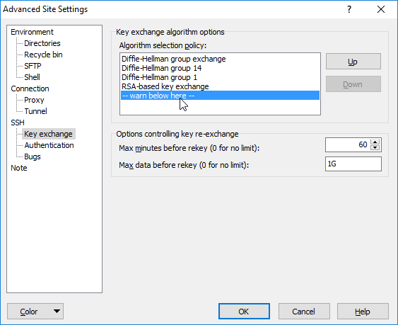

From the Advanced, SSH > Key exchange dialog, the Elliptic Curve Key exchange is not listed as an option.

Maybe I didn't include enough details to receive support:
Version of WinSCP: 5.7.7 build 6257
Version of Windows: tested on Windows 10, Windows server 2008, Windows Vista
Mode: GUI mode not scripting
Protocol: SFTP and SCP
Reproduction steps: simply trying to connect.
Odd situation: the server is a custom implementation of "mavericks" sshtools library version 1.6.16
https://journal.jadaptive.com/maverick-legacy-server/
The issue only arose after the server side disabled the key exchange version KEX_DIFFIE_HELLMAN_GROUP1_SHA1 to guard against the logjam vulnerability
