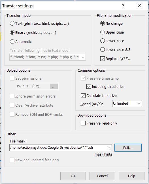

I need to transfer all folders, except for one where only a subset of files and folders are needed.
I tried the following filter mask, but it does not work as expected: nothing is transferred from the exception folder.
My understanding is that the file search is not recursive in the source folder: how can the mask be modified to attain the goal?
For example, the Ubuntu/*.sh files are located within numerous subfolders.
Another issue is that the mask is not automatically set for the next transfers: we have to reload it each time.

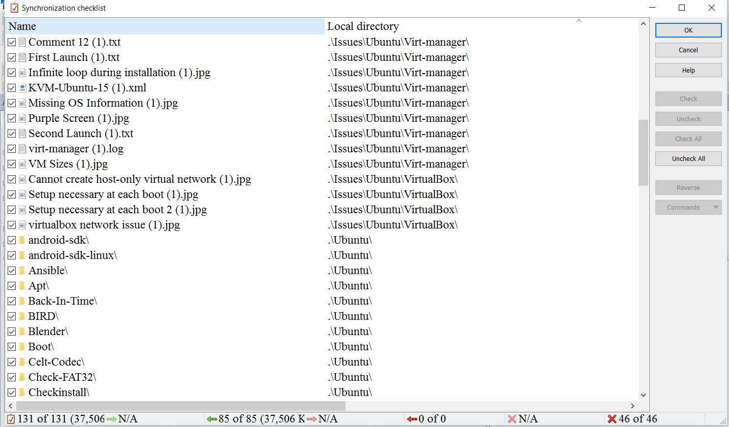

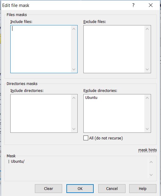

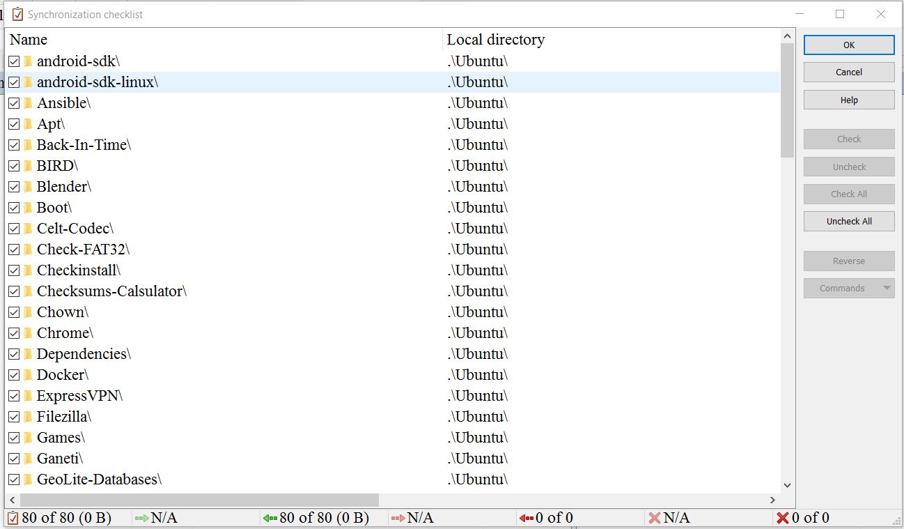

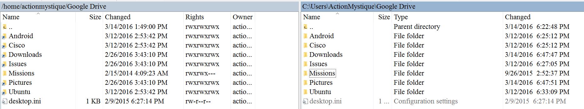

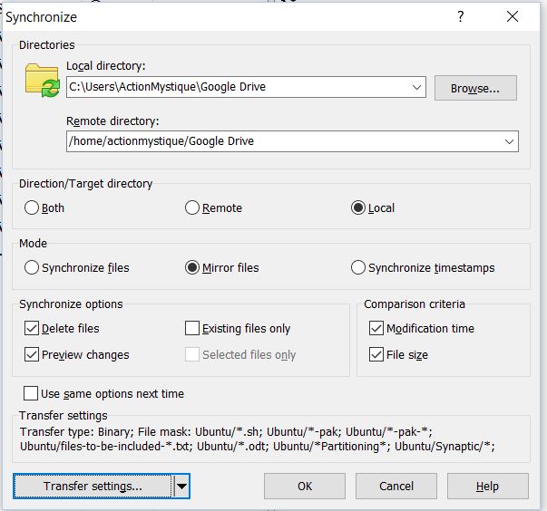

Two more issues with filtering.
1) Timestamps
There are some discrepancies between source and dest ("Date & Time Discrepancies").

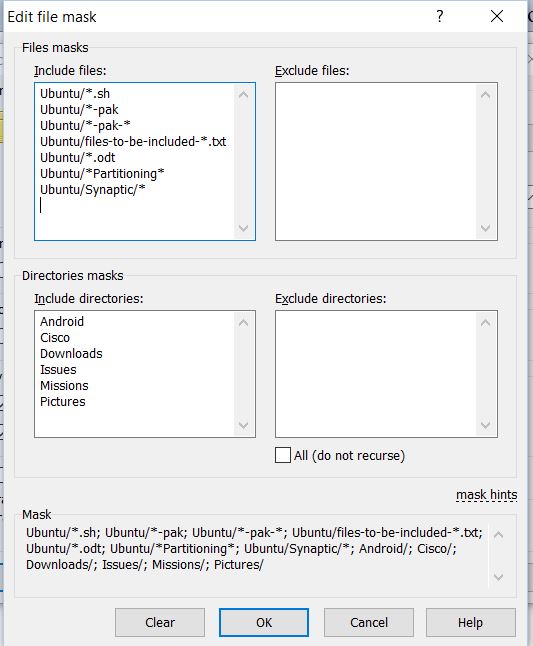

2) Excluding a folder or not
Excluding "Ubuntu" folder leads to nothing to do ("Without Ubuntu Filter Mask" & "Without Ubuntu Sync Results").
However, including all folders lead to some job outside of "Ubuntu" folder ("With Ubuntu Filter Mask" & "With Ubuntu Sync Results", cf. next post).

42,636
Re: How to always filter some files and folders during transfer?
Now, I'm not sure what you want to do.
Do you want exclude the .sh files or transfer only the .sh files?
For the timestamp problem, start here:
https://winscp.net/eng/docs/troubleshooting#timestamps
If that does not help, please collect the information mentioned in the article and start a new thread about this issue.
The Ubuntu directory exclude mask excludes all Ubuntu folders. So even the .\Issues\Ubuntu, not only the .\Ubuntu. If you want to exclude a specific folder only, use a full path.
See https://winscp.net/eng/docs/file_mask#path

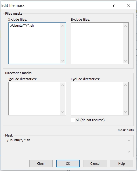

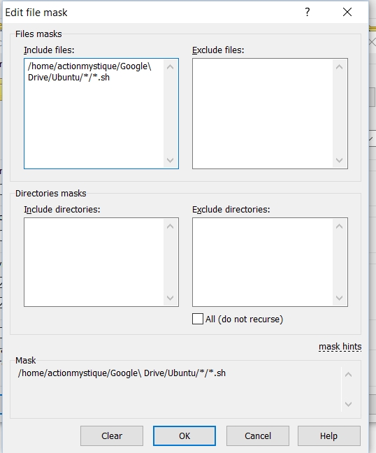

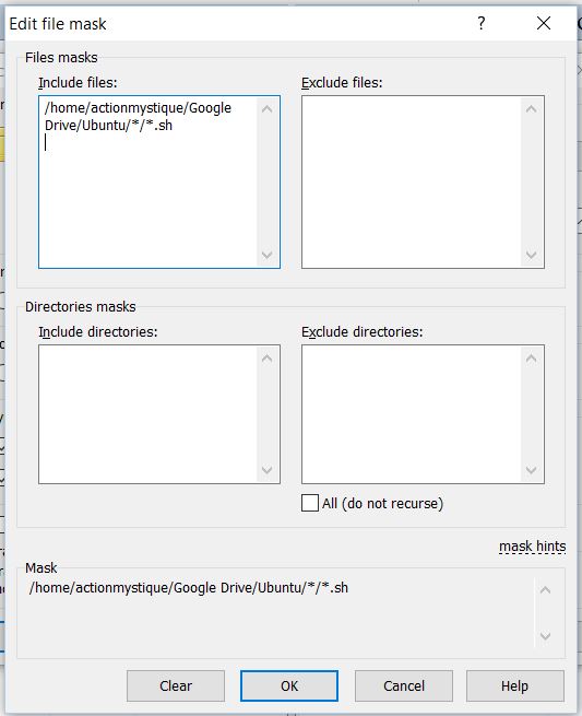

I'm trying to recursively transfer all *.sh which are located inside ./Ubuntu
Whether I put the source whole path from the root or the partial path from the current sync folder, the results are the same: WinSCP tries to transfer all subdirectories, instead of just *.sh located inside all subdirectories and all subsubdirectories and so on ("Whole source path" and "partial source path"). At least, that's how the results are shown on the "synchronization checklist".

OK, I removed the escape character; however, the issue remains: WinSCP wants to sync the whole Ubuntu folder even when specifying the whole path: /home/actionmystique/Google Drive/Ubuntu/*/*.sh

Please note that I could not perform the transfer (I cancelled at the sync checklist) because WinSCP is not able to apply the filter mask correctly.
Since the whole "Ubuntu" folder is selected by WinSCP instead of the filter, the destination space would not have been sufficient to hold all the data.
