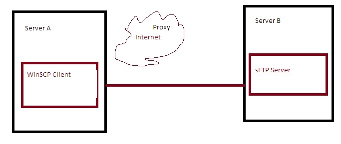

Could you also please let us know which server you thing has the bug in it.
Is it
Server A which has the WinSCP client? or
Server B which has the sFTP server installed or
WinSCP application bug?
Please see the diagram for more understanding of the example.
Thank You,
Viral
Of course the "Server B which has the sFTP server installed".
I do not know anything about the server, so I cannot help you further, sorry.
