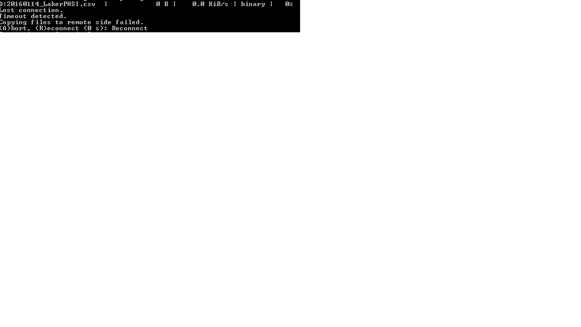

I am kind of new to using command prompt for winscp. If someone can please help resolve my error below it would be greatly appreciated. As I don't know what steps to take next and I have looked through all of the other boards. WINSCP version 5.5.6.0.
option batch abort
option confirm off
open ftp://username:password@server -passive -explicitssl
put "local file" "destination folder" exit
"Copying files to remote side fialed".If you need the working log, please instruct me on how to get it.

Can you even connect/list a directory with WinSCP GUI or any other FTP client?
I can connect and list a directory and transfer files manually. Is the network setup different between manual and automated file transfer?
It looks like the server is misconfigured or something is blocking a connection to the server.
Did you read the
https://winscp.net/eng/docs/ftp_modes
as recommended by a documentation to the error message "Timeout detected" that you are getting?
https://winscp.net/eng/docs/message_timeout_detected
Yes, I read the ftp modes article and there is more than one attempt to getting the file. I don't think the amount of time provided will solve this issue.
wanj
I attempted setting -timeout=500 and no sucess
Can a firewall or NAT effect the command prompt utility different than when I transfer a file manually?
Show us the manual log for comparison. The ftptest.net log is irrelevant as that connects from a different location than you do.

firewall or other network issue on server
I didn't test connecting with the GUI on the server until now. I was only connecting locally. Forum can be discontinued. thank you for your time. Great tool, very robust.
