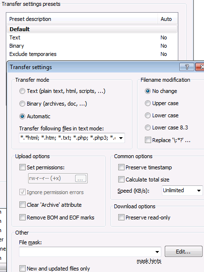

Using WinSCP Version 5.7.5 (Build 5665)
Protocol: SFTP
Port: 22
Error occurs Uploading file to NetApp server
Error occurs both using WINSCP GUI and command line interface
No errors occur downloading files
File size is relevant to the error:
Files under 10K: Error never occurs
Files 10K – 50K: Error is intermittent, occurring more frequently as the file gets larger.
Files 50K-100K: Error occurs almost all the time
Files > 100K: Error occurs all the time.
Whether the file is uploaded as binary or text is not relevant.
When the WinSCP GUI displays the error window, I click “Abort” and the file transfer operation completes.
The error is associated with the server handling of the SSH_FXP_CLOSE command. The server returns the status message: “no such file”, so the client logs: “Cannot Close Remote File”.
After I click “Abort” to the error, the server returns a directory listing (that includes the uploaded filename) without error.
NOTE: I have turned off temporary file renaming from the client to prevent uploading to a temporary filename and then renaming at the end of the transfer. That was a problem in the past because the FTS server does not allow file renaming.

richwink
5
Hello @martin – thank you for your reply,
I tried your suggestions: "disable preserving timestamp/setting permissions" (please see attached)
and still get the error.
The error does not occur with other clients e.g. CoreFTP.
