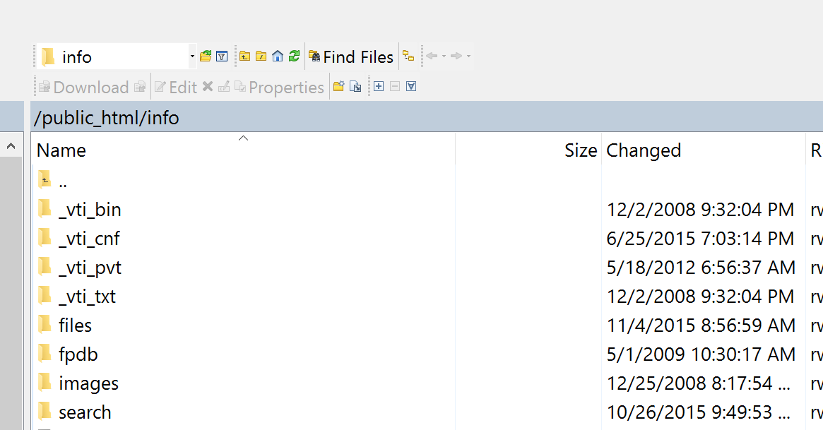

High resolution (3000x2000) causes tiny icons
Michele654
I found the place to set the font size, is there somewhere to set the icon size? If I didn't know the program so well, I wouldn't know which icon to use...
Description: Tiny icons, although I changed the font size

Re: High resolution (3000x2000) causes tiny icons
We are working on this:
https://winscp.net/tracker/1302
If you send me an email, I'll send you back a development version of WinSCP for testing. Please include link back to this topic in your email. Also note in this topic that you have sent the email. Thanks.

worked fine
I sent my Surface Book back, so I'm on my old computer and don't need the high resolution version. While I used it, it looked fine. Thanks for letting me try the beta, when I find another computer I will probably need it again.
