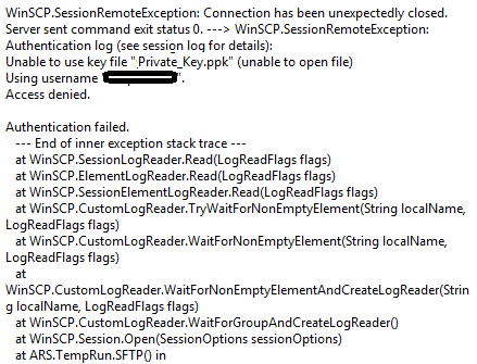

I receive the following error, see attached.

Description: I receive this error

The relative paths are resolved relatively to the location of winscp.exe (which may not be the same location as your application).
Better use an absolute path.
Path.GetFullPath("Private_Key.ppk")

I have updated my code to:
SshPrivateKeyPath = Path.GetFullPath("Private_Key.ppk")
Now the error list I receive now is:
Authenticating with public key "imported-openssh-key",
Further authentication required
Acess denied.
Authenication failed.
I have also placed WinSCP.exe in the same folder as my application and part of my c# project.
What I am missing or doing wrong?
