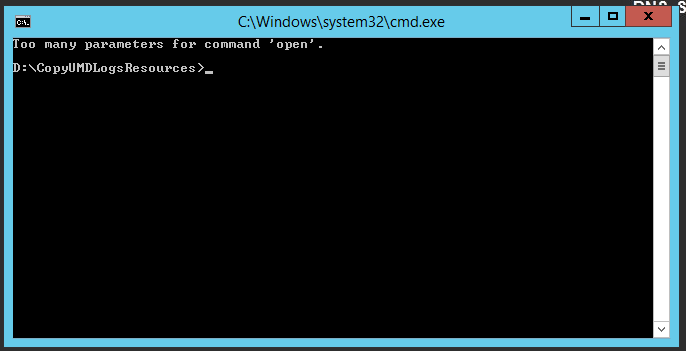

one problem left... When i enter the proper command into the commandline window directly, it works. But when i paste the line into a batch-file (.bat), i get following error:
too many parameters for command 'open'
What can i do? I am using the latest version. I want to add a job to the Task Scheduler for that, but i can´t because of this error.

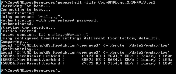

That is exactly my problem. When i paste this command into a cmd.exe window, the command works as it should. When i paste this line into a batch file and excute it, the "too many parameters" error appears.
But when i paste the command into a .ps Powershell sript file, it works!??
winscp_test.ps1
.\WinSCP.com /command "open scp://user:password@host" "synchronize local -filemask=>3D D:\UMD_Logs\04_ExternesTestsystem\srunavte2 /data2/umdav/log" exit
--/> See attachment, it works!

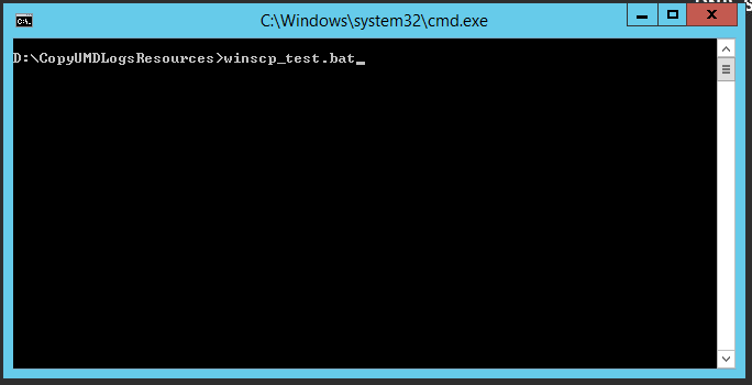

winscp_test.bat
cls
@echo off
exit
--/> See attachment, it does not work when this command is inside a batch file!

Description: Executing the command with a powershell sript
Description: Error when using a batch file that has the WinSCP command included
Description: Entering batch file to execute it
