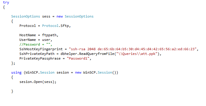

Private Key (.ppk) Error using .net Assembly
I'm facing below error while using WinSCP assembly in my c# code
Connection has been unexpectedly closed. Server sent command exit status 0.
Unable to use key file "PuTTY-User-Key-File-2: ssh-rsa
Encryption: aes256-cbc
Comment: rsa-key-20160909
Public-Lines: 6
AAAAB3NzaC1yc2EAAAABJQAAAQEA3vMOJJOGCZP+HrFLiWpuLG" (unable to open file)
Using username "m79971".
Authentication failed.
Attaching my code snippet.
Your quick response on this will be highly appreciated. Thanks in advance.
Description: Code Snippet...
