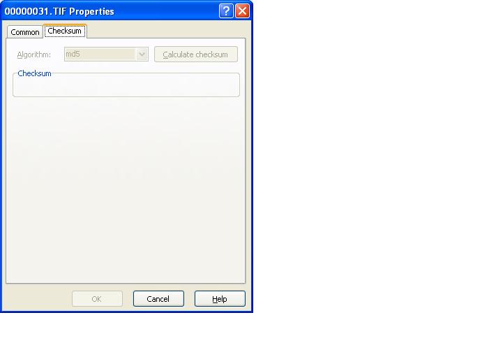

Dear Friends,
unable to check the MD5 check-sum value from check sum tab in file properties, it is in disabled,
can anyone help me out from this issue.
Thanks,
Suresh
Description: Checksum is disabled

Re: unable to check MD5 checksum value from FTP SERVER
As you can see in the FEAT response, your server does not support any of the checksum calculation commands (HASH, XSHA1, XSHA256, XSHA512, MD5, XMD5, XCRC). There's no solution.
