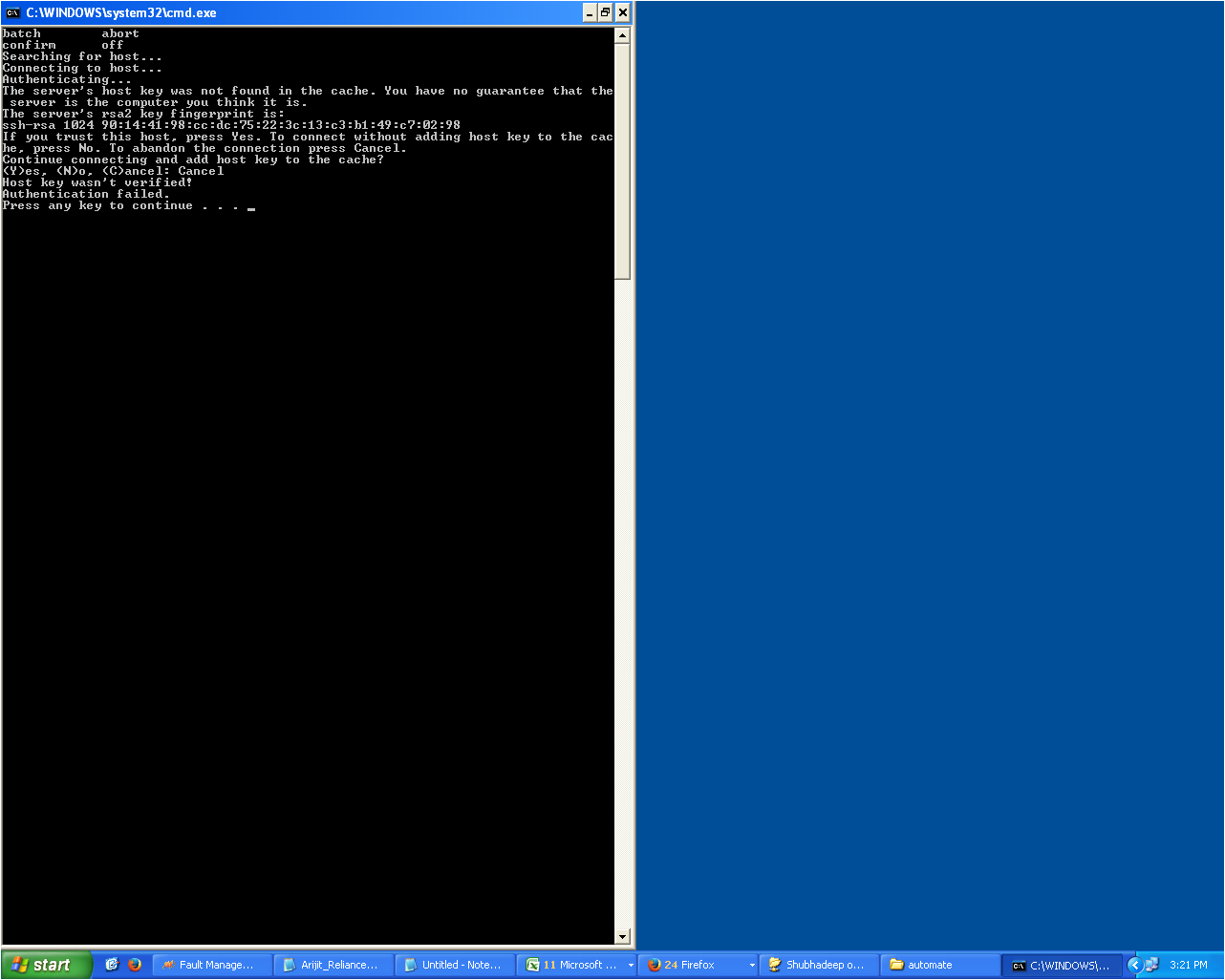

Description: Here i share the error while running the script

Re: Authentication failure/////Access denied
Checking the log file, your problem has nothing to do with the password. You do not even pass a hostkey verification. The reason is that you are using an ancient version of WinSCP (4.0.5 - 8 years old!) that does not support the -hostkey switch (let alone the %TIMESTAMP% syntax).
