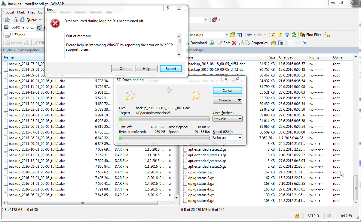

petr@...
Error occurred during logging. It's been turned off - TSessionLog::DoAdd
Stalo se mi to poprvé, při kopírování souboru. Dialog na pozadí dál běží, ale data nenabývají.
Re: Error occurred during logging. It's been turned off - TSessionLog::DoAdd
After closing the Error Dialog, the transfer continues.

Out of memory
(003E7440) System::DynArraySetLength
(003E7571) System::DynArraySetLength
(00359C03) System::Classes::TStringList::AddObject
(0072941C) TSessionLog::DoAdd
(0072955C) TSessionLog::Add
(007396A4) TSFTPFileSystem::ReceivePacket
(0073A2B4) TSFTPFileSystem::ReceiveResponse
(00767C73) TSFTPQueue::ReceiveResponse
(007508AC) TSFTPQueue::ReceivePacket
(00764B5E) TSFTPFileSystem::SFTPSink
(00760BEE) TSFTPFileSystem::SFTPSinkRobust
(007609E2) TSFTPFileSystem::CopyToLocal
(007856B5) TTerminal::CopyToLocal
(0000DCC2) TCustomScpExplorerForm::ExecuteFileOperation
(0000E91C) TCustomScpExplorerForm::ExecuteFileOperation
(0001D63F) TCustomScpExplorerForm::RemoteFileControlFileOperation
(0001D99C) TCustomScpExplorerForm::RemoteFileControlDDEnd
(00408B22) Customdirview::TCustomDirView::DDDragDetect
(00655392) TUnixDirView::DDDragDetect
(00404F84) Customdirview::TCustomDirView::CNNotify
(0024A0E5) Vcl::Controls::TControl::WndProc
(00292B57) Vcl::Comctrls::TCustomListView::WndProc
(0024ED8F) Vcl::Controls::_17076
(0024E270) Vcl::Controls::TWinControl::MainWndProc
(000374F1) USER32.dll
(00015C3B) USER32.dll
(0001581B) USER32.dll
(0001C167) USER32.dll
(00077E54) ntdll.dll.KiUserC
pdebaere@...
Une erreur est survenue lors de l''écriture du journal. Elle a été désactivée - TSessionLog::DoAdd
WinSCP 5.9.2
Une erreur est survenue lors de l''écriture du journal. Elle a été désactivée.
Out of memory
Trace de la pile :
(003E7440)
(003E7440)
(003E7571)
(00359C03)
(0072941C)
(0072955C)
(006A909A)
(006956D7)
(006A6D9C)
(006A7027)
(006A7113)
(006A716C)
(006A43CA)
(00775A3B)
(00774FC9)
(00774448)
(00653C98)
(00016BDC)
(0003CE17)
(0003CDD4)
(00372BEC)
(000152F7) USER32.dll
(00015D35) USER32.dll
(000167BF) USER32.dll
