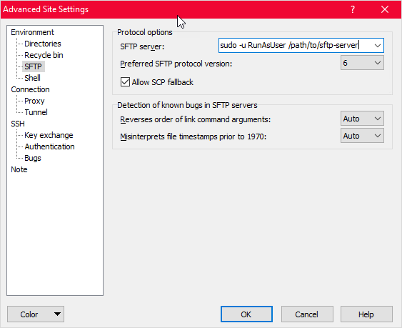

tedious
How to sudo as a different user in WinSCP
Posting the solution as obviously the top result for searching online falls on an admin that is unable to provide the simple answer...
Quick answer:
sudo -u RunAsUser /path/to/sftp-server
To locate /path/to/sftp-server:
locate sftp-server
which sftp-server
If both command fails, try the paths in the doc: https://winscp.net/eng/docs/faq_su
Long answer:
Basically the SFTP server field in Advanced Settings is a command line, so you only need to add the command to sudo as another user.
What is suggested in the official doc is to just elevate sftp-server permission to root (default value if -u is not provided). As -u is not required for root, it can get confusing as to how to set up the connection as another user.
  • Elevate sftp-server to root permission.
    Requires the permission to be set in sudoers.conf
    sudo /path/to/sftp-server
  • Elevate sftp-server to another user permission
  • Another command that I found being passed around is
    sudo su RunAsUser -c /path/to/sftp-server
    It achieves the same thing in a different manners. Either worked for me.
Re: How to sudo as a different user in WinSCP
@tedious: Thanks for sharing you findings.
Though note that @tdecoursey obviously knows how to switch the user in shell. So the problem was not learning about the -u switch or sudo su or in general what command to use.
That's why I do not understand what the problem was about.
