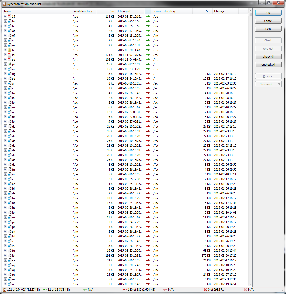

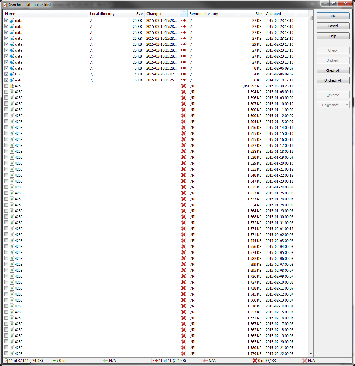

Certainly... I've got some more data for you. I'm using a modestly-powered workstation and did the following tests on version 5.7.1. I have also attached screenshots (with most of the filenames blanked out).
For a changeset of 37,000 items, the window took 2 minutes 30 seconds to display (14800 items per minute)
For a changeset of 294,000 items, the window took 3 hours 10 minutes to display (1547 items per minute)
During this time between analysing the directories and the window showing, the application is unresponsive, and Task Manager shows it's using 100% of the core it's running on, while it continues to allocate a mere 30KB per second.

Description: 294,063 items, 3h10m
Description: 37144 items, 2m30s
