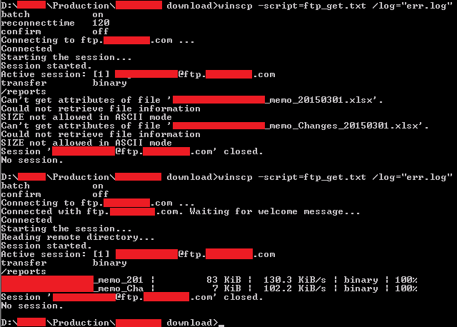

Hi I have updated the WinSCP from 5.5.4 (Build 4433) to 5.7 (Build 5125). For most of the ftp servers my vbs connect to are working fine with the latest update. However, I noticed this one ftp server is having problem downloading using the "get" command in batch mode. I keep getting the following issues:
    -Can't get attributes of file
    -Could not retrieve file information
    -SIZE not allowed in ASCII mode
I also tested the same script using the previous version I have (v5.5.4) and it works fine. Is there some fundamental change to the "get" command for the latest version that causes this behavior? I have also attached the log files from both test for your reference.
It's this change:
https://winscp.net/tracker/1209
While your server claims support for SIZE command, its implementation seems to be limited to binary mode, what WinSCP does not expect.
