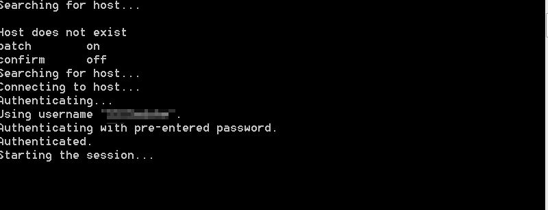

Now, if I introduce a parameter with the codes below i'm getting "Host Does Not Exist"
BAT File
@echo off
cls
C:
cd\BOTDataImport
winscp417 /console /script=script.txt /parameter BV_201503.zip
pause
Script.txt
option batch on
option confirm off
open SSIS@Server
get /Source/%1% C:\WorkingDirectory\
close
exit
Hope someone can lead me to the right direction.
Many thanks guys
Description: error log host doest not exist

The ancient version of WinSCP you are using (4.1.7, over 6 years old) does not support /parameter.
Please upgrade.
