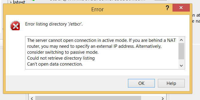

I have attached two log files and an error message (png). Log1 is attempt to login in PASSIVE mode. Log2 is an attempt to login in ACTIVE mode. Also attached is a snip showing the error message I received when trying the ACTIVE mode login.
You wrote that I need to use passive mode, but everything I have read and heard has told me that if I am behind a NAT router that I must use ACTIVE mode. The other person using this FTP site (and other FTP sites) (using the same host, user name, password) connects and accesses the directory listing from his computer in ACTIVE mode without problem. Only difference between my computer and his is he has Windows 7 OS and I have Windows 8.1. And with my old laptop with the Windows 7 OS, I never experienced any problems with the FTP site.
I do not have a static IP address so cannot specify one.
I removed the host name and user name from the Logs, and hope that they are not relevant to the problem.

Description: Active mode login attempt

Well, you can connect in active mode, if you are behind a router. But you need to specify your external IP address (as the server sees you) in WinSCP preferences.
See https://winscp.net/eng/docs/ui_pref_network
And you need to open your firewall for incoming data connections.
In passive mode the same setup has to be done on server-side. What is more common, as it's one-time configuration that allows any user to use the server. While in active mode, all users have to setup their firewall.
See https://winscp.net/eng/docs/guide_windows_ftps_server#firewall
