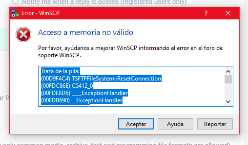

ShawnKLewis@...
Invalid access to memory - TSFTPFileSystem::ResetConnection
WinSCP 5.15.1
(007DB1F8) TSFTPFileSystem::ResetConnection
(0092636E) C5153_3

mariottifederico@...
Acceso a memoria no válido - TSFTPFileSystem::ResetConnection
WinSCP 5.15.3
Traza de la pila:
(007DC47C) TSFTPFileSystem::ResetConnection
(00087C8F) ntdll.dll
(007DB3D3) TSFTPFileSystem::~TSFTPFileSystem
(00811F67) TTerminal::~TTerminal
(00750C4B) TSecondaryTerminal::~TSecondaryTerminal
(00750933) TBackgroundTerminal::~TBackgroundTerminal
(0074BDCE) TTerminalItem::~TTerminalItem
(0074A5C9) TTerminalQueue::~TTerminalQueue
(000ABA16) TTerminalManager::FreeTerminal
(000AAF17) TTerminalManager::FreeActiveTerminal
(00274C04) Vcl::Controls::TControl::MouseDown
(00274C9C) Vcl::Controls::TControl::DoMouseDown
(00274E81) Vcl::Controls::TControl::WMMButtonDown
(0027919D) Vcl::Controls::TWinControl::WndProc
(002787E4) Vcl::Controls::TWinControl::MainWndProc
(000438E9) USER32.dll
(00025137) USER32.dll
(0047ADD7) Dragdrop::TDragDrop::WndMethod
(00024289) USER32.dll

sergio.amillano@...
WinSCP 5.19.3
Traza de la pila:
(00D89880) TSFTPFileSystem::ResetConnection
(0006246E) ntdll.dll
(00D887D7) TSFTPFileSystem::~TSFTPFileSystem
(00DBFC57) TTerminal::~TTerminal
(00CF807B) TSecondaryTerminal::~TSecondaryTerminal
(00CF7F17) TBackgroundTerminal::~TBackgroundTerminal
(00CF3252) TTerminalItem::~TTerminalItem
(00CF19FD) TTerminalQueue::~TTerminalQueue
(000B0AC2) TTerminalManager::FreeTerminal
(000AFEEF) TTerminalManager::FreeActiveTerminal
(0027F95C) Vcl::Controls::TWinControl::MainWndProc
(00015307) USER32.dll
(00015D45) USER32.dll
(0001FD6A) USER32.dll
(0001FD90) USER32.dll.CallWindowProcW
(0049E69F) Dragdrop::TDragDrop::WndMethod
(000167D2) USER32.dll

rmarcano@...
<Upon closing a session, error appeared:[/code]
[code]<Upon closing a session>
<Traza de la pila:
(00D9F4C4) TSFTPFileSystem::ResetConnection
(00FDC86E) C5412_0
(00FDE8D6) ____ExceptionHandler
(00FDB690) __ExceptionHandler
(00087B7F) ntdll.dll
(00D9E41B) TSFTPFileSystem::~TSFTPFileSystem
(00DD5B03) TTerminal::~TTerminal
(00D07A37) TSecondaryTerminal::~TSecondaryTerminal
(00D078D3) TBackgroundTerminal::~TBackgroundTerminal
(00D02C0E) TTerminalItem::~TTerminalItem
(00D013B9) TTerminalQueue::~TTerminalQueue
(000B3A7A) TTerminalManager::FreeTerminal
(000B38B2) TTerminalManager::FreeAll
(000B276F) TTerminalManager::~TTerminalManager
(000B222C) TTerminalManager::DestroyInstance
(0010B181) Execute
(000027FA) wWinMain
(00FDA881) __wstartup
(00066BBC) ntdll.dll.RtlGetAppContainerNamedObjectPath
(00066B89) ntdll.dll.RtlGetAppContainerNamedObjectPath[code]>

credito.cobranza@...
WinSCP 6.1
Rastreo de la pila:
(00290ED3) System::SysFreeMem
(01004C0A) C6085_3
(01006C72) ____ExceptionHandler
(01003A2C) __ExceptionHandler
(00087ACF) ntdll.dll
(00FF2B0F) ___org_free
(00FDE7F9) C4100_0
(00DBD6AA) TSFTPFileSystem::ResetConnection
(00DBC7FD) TSFTPFileSystem::Close
(00D6AE82) TSecureShell::FatalError
(00D69BBB) TSecureShell::TimeoutAbort
(00D6BE64) TSecureShell::WaitForData
(00D691BE) TSecureShell::Receive
(00DC143A) TSFTPFileSystem::ReceivePacket
(00DC29E4) TSFTPFileSystem::ReceiveResponse
(00DD2C80) TSFTPFileSystem::ReadDirectory
(00E02638) TTerminal::CustomReadDirectory
(00E019A1) TTerminal::ReadDirectory
(00DFCC4F) TTerminal::ReactOnCommand
(00DFDCFD) TTerminal::SetCurrentDirectoryW
(00C93E2E) TUnixDirView::SetPath
(0002D4EE) TCustomScpExplorerForm::DoRemotePathComboBoxItemClick
(0005FB1C) TScpCommanderForm::DoRemotePathComboBoxItemClick
(00040399) USER32.dll
(00037365) USER32.dll
(000350D5) USER32.dll

Re: Error listing directory '/userdata/roms/saturn' - TSFTPFileSystem::ResetConnection
@davecramer7: Thanks for your report.
przemyslaw.wolinski@...
Nieprawidłowy dostęp do pamięci - TSFTPFileSystem::ResetConnection
I think it happens when trying to connect/open a folder on a server with more than 200-300 files in it.
WinSCP 6.1.1
