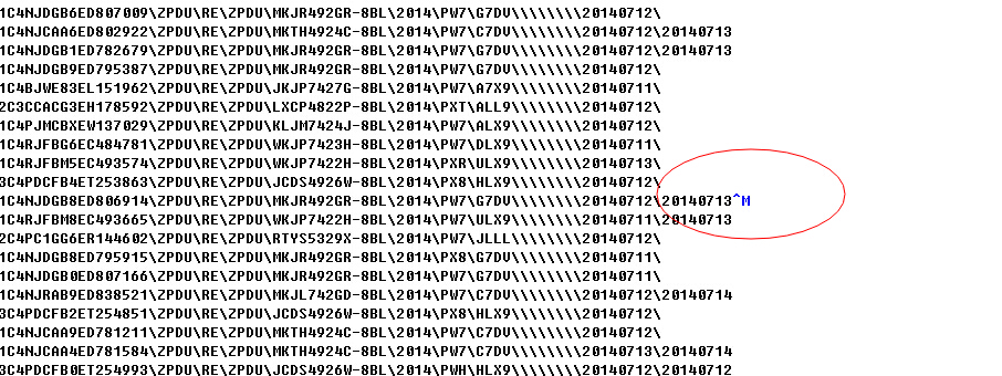

Line break happens randomly with receving files by winscp.
I have checked that the source file in sftp server is ok(have out line break).
How it happens?
there are some logs below:
2014-07-14 12:53:11.829 Script: get -delete /cust/ctcai/out/ZPDU/*.txt E:\Interface\dcssftp\out\ZPDU\

Description: screenshot for the file received.
