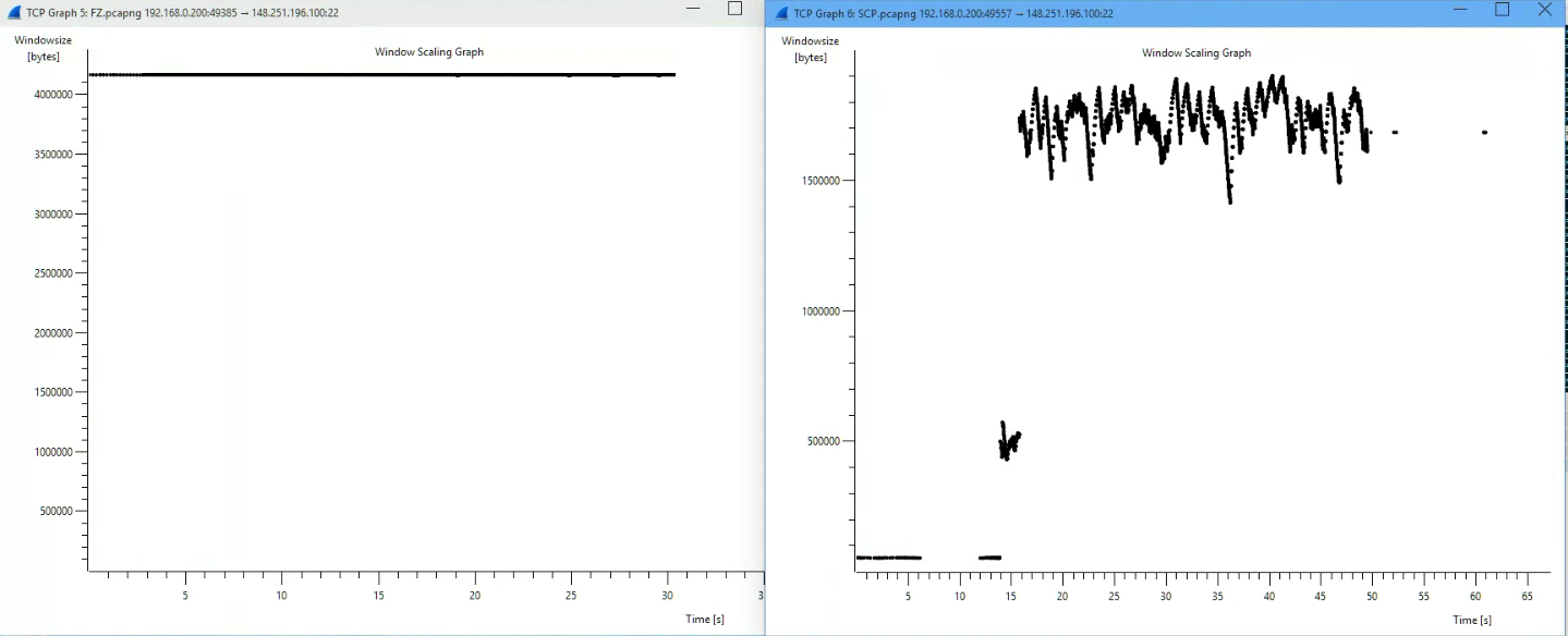

I've run some Wireshark traces comparing a WinSCP download and FileZilla download. The main thing that stands out to me is the TCP window size, and time to send ACKs (keep in mind I have some networking knowledge but am in no way an expert!).
According to Wireshark's calculation Filezilla uses a fixed TCP window of 4194304 bytes from the very beginning, where WinSCP appears to use the more "standard" ramp up technique and hovers around 1700000 bytes once the download gets going. I'm unsure why it doesn't continue to increase. I didn't notice any significant CPU load during either download. I also tried alternating between AES and Blowfish encryption in the WinSCP options but this didn't make any difference (FileZilla uses AES by default).
It's a bit hard to show plots of SEQ/ACK response time, but in Wireshark there is a SEQ/ACK analysis field that gives "RTT to ACK the segment" and FileZilla was consistently around 0.00002s whereas WinSCP seemed to be a lot more inconsistent, ranging from 0.00004s up to 0.00007s
Furthermore, looking more closely at the way the packets are coming in, both downloads follow the pattern of receiving "full" packets of 1460 bytes, until there is one final smaller packet (assuming this is the end of the TCP window), before repeating. The FileZilla download takes 90 packets of 1460 bytes, and 1 packet of 184 bytes for a total of 131584 bytes (I don't know why it doesn't fill out the entire 4194304 window but as I understand it doesn't necessarily HAVE to). This repeated cycle takes consistently 0.017s, giving about 7.7MBps, or 61Mbps. Note that there are still plenty of ACKs being sent back throughout the cycle - about 1 ACK reply per every 2 packets received.
In contrast, WinSCP only takes 11 packets of 1460 bytes before a final 388 byte packet, totaling 16448. Time taken for each cycle varies significantly from 0.0015s up to 0.06s. The 16448 byte transmit window divided by the 5MBps throughput confirms an average cycle time of 0.003s. Again WinSCP is quite inconsistent with the ACKs sent per cycle, ranging from 1 every 2-3 packets received up to 7-8.
So what does it all mean? Well like I said I'm not an expert :) I would be interested to see if it's possible to fix the TCP window size used by WinSCP to something larger, and I guess maybe looking into the mechanisms of how the two programs process ACKs. FileZilla is open source after all :)
WinSCP 5.7 has download window of 4 MB too. Please try to upgrade and let us know if you see any change.

Is this for a single-file download or total throughput for concurrent downloads of several files?
This is for a single file download - FileZilla hits about 60Mbps where WinSCP is limited to 5Mbps (per file/session).
Unfortunately I saw no improvement. The behaviour of sending 11 packets of 1460 bytes before a final 388 byte packet over the 0.0015s up to 0.06s timeframe remained consistent even with the increased TCP window.
Let me know if you'd like any other testing done - WinSCP's scripting interface sets it apart from all the rest so I'm more than happy to help with any improvements!

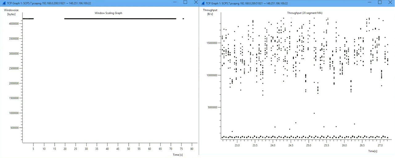

Here are the results:
Files in email:
psftp.exe - downloaded at 46-48Mbps via command line interface
psftp_32.exe - downloaded at 46-48Mbps via command line interface
psftp_64.exe - downloaded at 46-48Mbps via command line interface
FileZilla - consistent 61-62Mbps
WinSCP v5.7 - 4.9Mbps via standalone GUI app
WinSCP v5.5.4 (original version my scripting is set up with) - 4.9Mbps via standalone GUI app
I then went and checked my existing psftp.exe in the directory where I have been using the standalone WinSCP application, and it also downloaded at 46-48Mbps via command line. I guess there an issue somewhere with how the WinSCP application interfaces with psftp?

Thanks for your comprehensive tests.
Could you please enable Debug 2-level logging in WinSCP and attach a log from the test?
