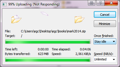

I've been using WinSCP for a *loong* time, and, recently (past ~2 years), quite successfully in uploading large-ish files (say, in the 500 meg -> 1.5 Gb range) to one of my cloud accounts (generally, one hosted by box.com). Normally, this works perfectly, but recently (either because of a change in 5.5.3 versus earlier versions, or something on the Box side), this isn't working very smoothly.

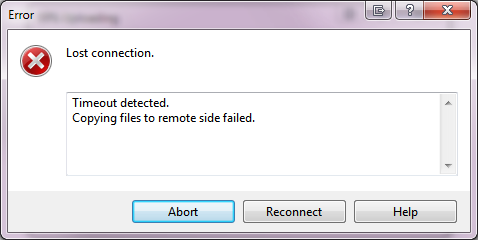

I connect to Box using passive ftp with explicit TLS encryption. Port 21 (nothing particularly fancy here). Start the transfer, and then right at the end (say, 99% mark) the status bar for WinSCP reports '99% Uploading (Not Responding' (see attachment, Fig. 1). Then, after 10-15 seconds, I get an error box (see attachment, Fig. 2) saying 'Timeout Detected, Copying files to remote side failed'. If I hit 'Reconnect', then WinSCP connects, and the final bits of the transfer seem to complete.
But, beyond the inconvenience of having to wait and hit the 'Reconnect' button, I have no easy way of determining if the file transfer has in fact completed, or if file integrity hasn't been compromised while WinSCP seems to be hanging.
