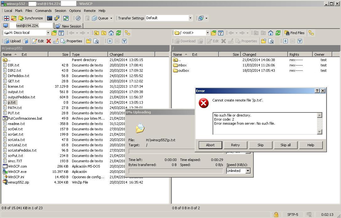

I am scripting this simple code
open test:password@194.224.XXX.YYY
put .\sincc.TXT
bye
But it doesn't work. WinSCP says
Error code: 2
sincc.TXT exists next to the WinSCP executable.
Why?
I will attach the log.
Thanks in advance. Sorry for my English.
Re: "Error code: 2" in simple PUT
A full error message is:
Cannot create remote file '/sincc.TXT'. ("No such file or directory.
Error code: 2
Error message from server: No such file."
The error comes from the server. It can have many reasons.
Thanks for the reply
I was not able to upload any file using WinSCP GUI (see attached), but I was able to upload any file using another GUI (like CoreFTP).
Oh! The message "Error code 2 no such file" which is true but because I'm uploading, gave me a reason to prove one thing: if the file exists in the destination, it works the upload! However, this is just a patch, because it is normal that the file upload is not there, of course.
Thanks for the reply again.
Already solved the incidence posted. It seemed to be something on the server and, as I think you were suspecting now, seemed to be some about versions, because we resolved with an update to the sftp server.
