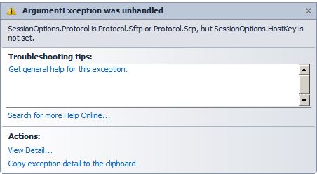

I am new to this forum, and was wondering if this has been resolved? I am having the same problem and have been looks for some time to resolve this. Below is my code. I tried to get a session log, but it never gets connected so there is not one. This error on the open statement. This is written in VB .NET 2010 Express.
One more thing, I wrote a VB Console app to execute the WinSCP that used a script file and work worked perfectly. The only issue I had with this method was lack of visibility and control of what may happen in an error situation. So I know all Of the parameters and Public key work.

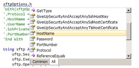

Thank you for the response, but I cannot seem to find the property Hostkey within Sessionoptions. :(
I am really trying to not have to use SshHostKeyFingerprint as this application will be used by multiple businesses and it would be much easier to handle the key by filename instead of Fingerprint. I have included a jpg showing where I am looking for the Hostkey property.
Thank you
