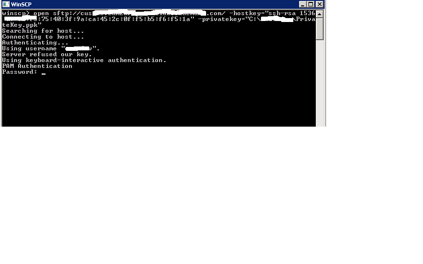

Re: Private key works in GUI but not console
BD98037 wrote:
I got the same issue: Private key works in the GUI but not console. I'm attaching the screenshot. Would you please take a look and advise?
Please attach a complete log file both from GUI and script.
