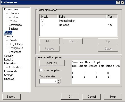

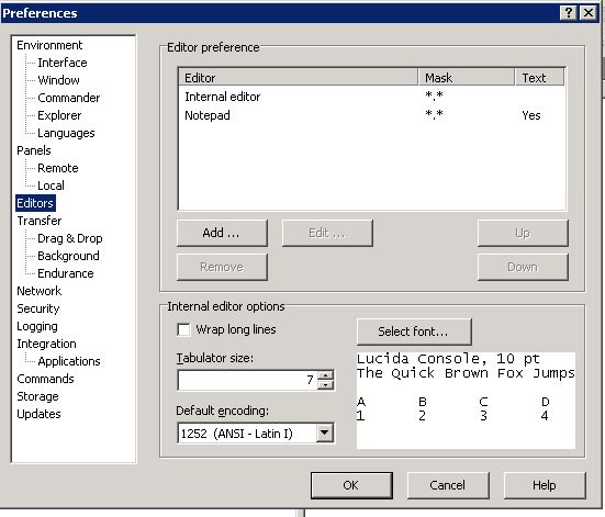

I am using SFTP protocol in both cases however i had made a mistake in the revisions. The new version is indeed 5.5.1 however the old version is not 5.1 but is in fact version 4.3.5 build 1463, apologies.
If I transfer the same file from the same location using version 4.3.5 and then open it with the internal editor of 5.5.1 then the three characters do not appear when the encoding is changed between UTF-8 to 1252 ANSI latin 1 and back again. However do exactly the same with version 5.5.1 and they do.
I have enclosed two images from both versions showing the Editor page.
In version 5.5.1 I have tried the transfer with both 1252 ANSI chosen as default and then UTF-8 with the same result.

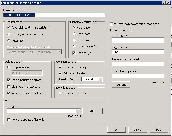

I had previously set WinSCP to remove the BOM remarks but to no avail. The system basically picks up a file from a server and places it into a folder on an SFTP server. Is there something I'm doing wrong?

So when you have the BOM removing enabled, does the BOM disappear from the file on upload or not?

With remove BOM enables it does not appear to remove the BOM characters from the file.

Please attach a full log file showing upload of a file using 5.5.2 with BOM removing enabled (but not happening).

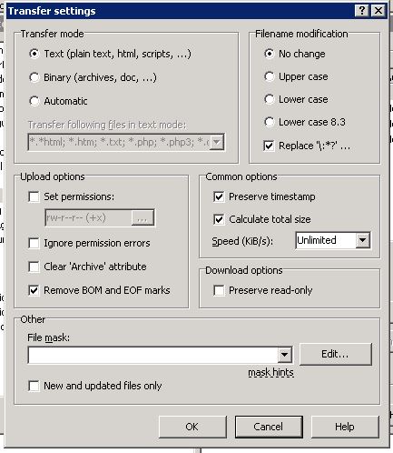

scripting question
unfortunately this issue was resolved but has occurred once again. I have included a screen shot of the transfer settings. When i manually copy one file from the source to the SFTP server from within WinSCP GUI interface these settings are utilized and I am happy, however when I use a script it ignores these settings and the file contains the three characters once again (as the original also does) Is there a better way to transfer files though a script that will force it to use the settings listed? I have not only added a new settings config but also changed all the others that come with WinSCP to match thinking it must use one of them, but it appears not.

Is there a way to force the script to use the transfer settings or should I be using a different command to complete file transfer?
Many thanks
Description: screen shot showing transfer settings
