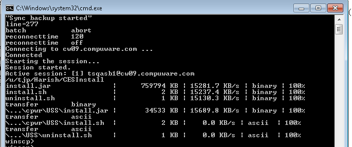

I am trying to exit from WinSCP in a batch file to to do other activity . It is not not coming out and still stays like winscp>. I am trying to send files through FTP from Windows to Unix machine.
"C:\Program Files (x86)\WinSCP\winscp.com" /command ^
 "option batch abort" ^
 "option reconnecttime off" ^
 "open ftp://tsqasb1:TSQASB1@cw09.compuware.com:21  -rawsettings SendBuf=0 Compression=1 -timeout=999" ^
 "cd /u/tjp/Harish/CESInstall"^
 "binary"^
 "put ""\\ddd-netaff1\Boerpps01\vdev\CEES\Build\trunk\archive\%%a\USS\cpwr\USS\install.jar"" ./"^
 "exit"
Anybody can help on real quick.

Hello am not able to exit from the WinSCP.
Even the exit command itself not taking.
If use the exit command before the put, it is working, but if I call the exit after the put it not getting out of the WinSCP.
