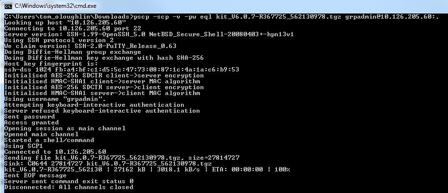

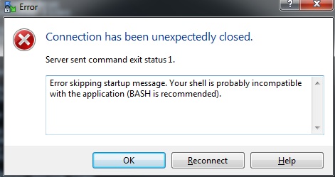

The device I'm connecting to does not have /bin/bash. When I specify /bin/sh in the Advanced Site Settings I get the following error:
Error skipping startup message. Your shell is probably incompatible with the application (BASH is recommended).
https://winscp.net/eng/docs/ui_login_scp#shell
WinSCP v5.5.1 and I also tried older revisions as well, 5.2.4.
Client OS: Windows 7. Tried on 64bit and 32bit systems.
Using Linux (RHEL/ubuntu) SCP, Putty SCP, Cygwin SCP, all work fine.
The device uses NetBSD 5.0 for SSH services.

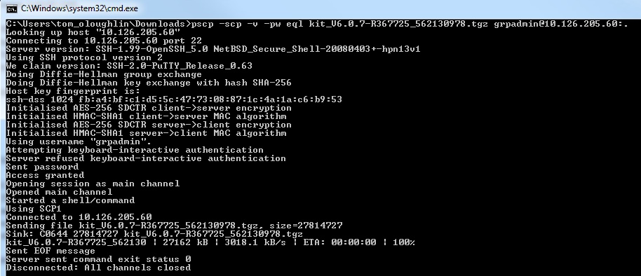

Description: Screenshot showing PSCP working to same device.
Description: ScreenShot showing error message

And that's exactly the reason WinSCP won't work.
See https://winscp.net/eng/docs/requirements#scp
At issue is WinSCP expecting /bin/bash. This device only has /bin/sh. When you try to specifiy /bin/sh it errors. Please see the attached screenshots. Older versions of this devices firmware, had /bin/bash and WinSCP worked fine then.

If I do that, the putty session logs in and then exits.
At issue is with SCP, not an interactive SSH login.
This is what I can't do with WinSCP, that I can with Linux SCP or Putty PSCP.
c:\Program Files (x86)\PuTTY>pscp c:\upload\fixpool.sh grpadmin@10.126.205.100:.
grpadmin@10.126.205.100's password:
fixpool.sh | 0 kB | 0.8 kB/s | ETA: 00:00:00 | 100%
