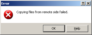

I think only since WinSCP version 5.5.1 (maybe one version previously sometimes as well, not sure) I have now quite often when I try to download (and edit) a file (by DoubleClick) this error:
"Copying files from remote side failed."
see attached sreenshot of this error message.
There seems to be no rule when I get it, but it is normally working when I doubleclick the file a second time. It is not every time, but a bit too often.
So it is a bit annoying but not soo dramatic.
Seems to be a bug, I guess.
I am on Windows XP (SP3, 32)

Description: Error - Copying files from remote side failed.

Sorry, I just replied to this tread, because I thought I don't need to open a new one, with the same Subject, but maybe because this first bugreport is not complete, better I make a new and thorrowful complete bugreport?
If not, just answer here, that I know that this tread is wellknown and read by dev.

Thanks for your reports.
I have sent both of you an email with a debug version of WinSCP to address you have used to register on this forum.

Thank you for this test version 5.6.0 (Build 3977) which I had to remove from spam folder ;)
No, the bug is still present.
I have again this error message.

The bug is definitely not fixed in the debug version. I need you to send me a trace file as per instructions in the email.

Sorry I didn't read the instructions, I didn't follow the link in the mail.
OK I sent you now a trace log when the error occured (which I had to cut a bit, there are plenty of private data/logins present!!!).
Sent with email to your address (martin@...) as reply to your mail.
