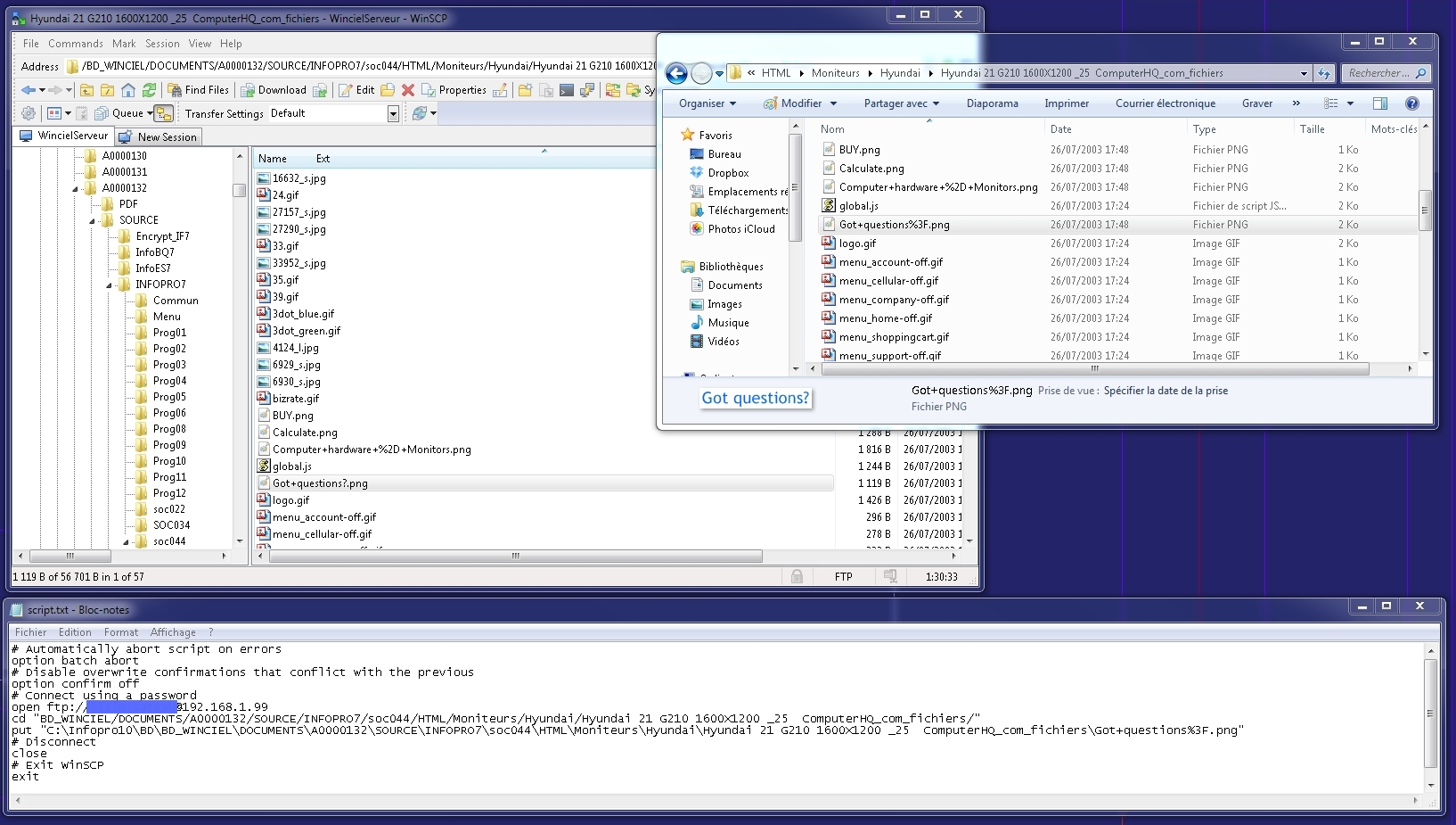

PUT with special codes %xx in the filename
I use the scripting automation to transfer files, and everything works fine.
Just one exception, when I try to transfer the file "Got+questions%3F.png"
So, wincsp tranfers the file on the serveur (linux debian 6).
But the filename becomes "Got+questions?.png" on the linux server.
I understand that it is because "%3F" is understood as "?" (special character).
But, if I write "put Got+questions%253F.png", Winscp answers that the file "Got+questions%253F.png" doesn't exist (can't find it).
So, what do you think, how can I make Winscp not "understand" the code "%3F" in the filename, and correctly name the file on the linux server ?

Description: filename, before after
