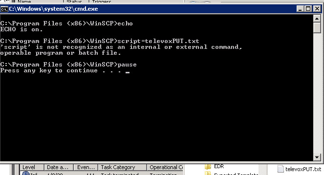

Running .bat file within the C:\program files (x86)\WinSCP\ folder -
script=televoxPUT.txt
ren jcmr.txt jcmr.old
exit
getting this error 'script' is not recognized as an internal or external command, operable program or batch file
see the attachment.

Well, I do not see how this is related to WinSCP.
Anyway, if you are trying to set value of environment variable script, you need to use set command:
set script=televoxPUT.txt
