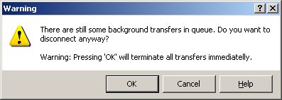

If I close WinSCP I can do it, then I get:
There are still some background transfers in queue. Do you want to
disconnect anyway?
Warning: Pressing 'OK' will terminate all transfers immediatelly.
But how can I do this without closing WinSCP?

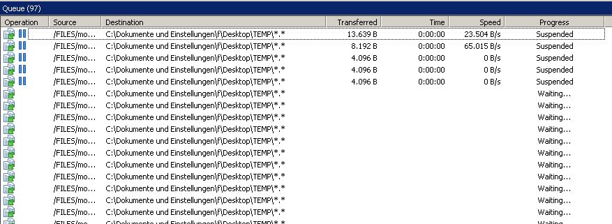

Look, this happens, when I have a long list and I go to All / Cancel:
See attachment "Transfer List".
Only the actual transferred files get suspended, all the "Waiting" are untouched.
When I quit WinSCP I get this:
See Attachment "Quit WinSCP"
This should be possible without quitting WinSCP.

I understand that Cancel All command is needed. Will add it.
But you talk (also) about Suspend All, what is like "pause", not "delete". And there's no need to "pause" transfers that are not transferring yet.

You absolutely right, I don't ment suspend, I mean cancel!
Great if you do this, this will be goodly feature and is very straight forward in using WinSCP.
