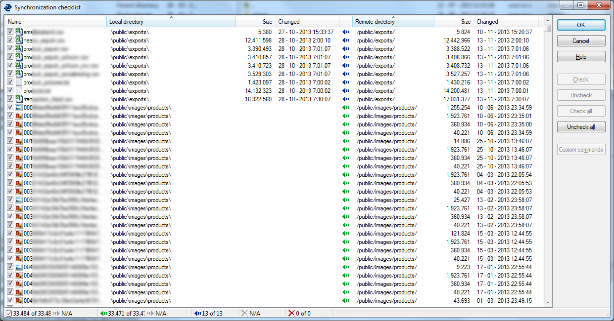

I'm using the newest version of WinSCP and I'm trying to exclude a couple of directories from syncing but I can not get it working. I've set the following excludes:

But after all those rules it's still trying to transfer those files (see attachment). Anybody who has an idea what I'm doing wrong?
