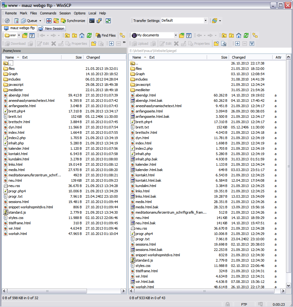

WinSCP shows all remote timestamps 1 hr larger than
a) local upload time
b) timestamps shown with command line ftp dir
c) other FTP program.
I attached a screenshot of the WinSCP screen and a command-line-FTP-dir-screen.
Also I attached a log-level-1-file, which does not contain much, as I did only open the connection to look at the file listing.
This is probably why autosync doesnt work.
Thanks for your good work.
Dominik
Description: screenshot of winscp after only opening the remote directory.
Description: Screenshot of command line ftp dir

you can look at any file. Every file in the remote-window of WinSCP had a timestamp exactly 1 h "later" than in the windows-command-line-FTP-dir-window.
In the log, every file has its correct UTC timestamp, as it should have according to:
https://www.rfc-editor.org/info/rfc3659/#section-2.3
Windows displays the time modified according to the actual time zone setting, which was GMT+2 (now is GMT+1).
Somehow WinSCP displayed GMT+3 during daylight saving time for the "remote" window.
Maybe it's a strange error occurring at the last day of DST...
