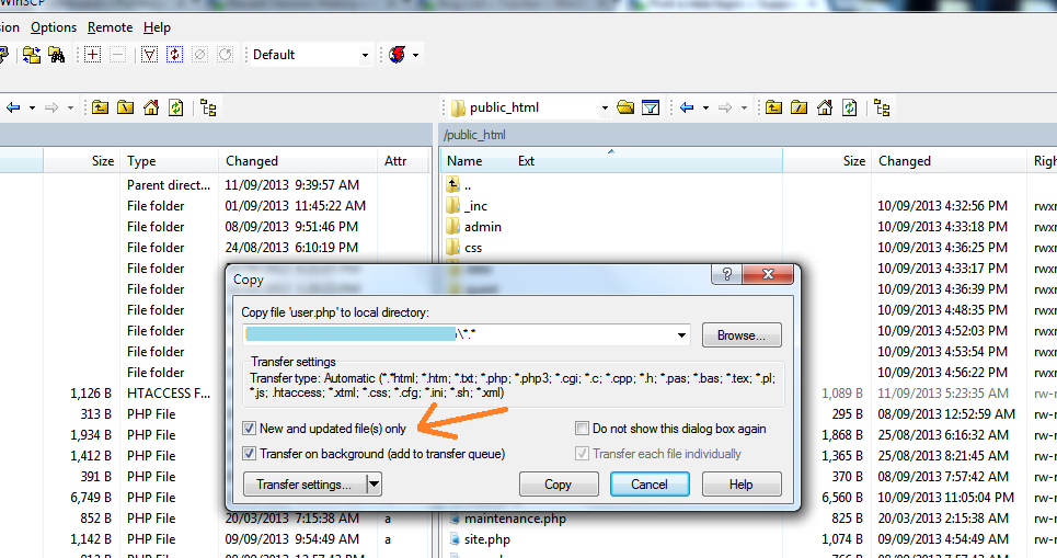

1) I upload the newer files on the server.
2) I update some of those files using any editor (Any File editor with FTP like, PhpDesigner) within an hour or so.
3) Download all files using WinSCP with 'New and updated file(s) only' option checked. (snapshot attached)
Here is the bug, Even the files on the server are updated but it still does not download the files and consider my local files as the updated version. This only happens, if i update the server's files within the timezone difference. If i update the server's files after a day or two, it works perfectly.
So, I think its all happen because it does not convert the dates to GMT before comparing them.
I hope this will also be fixed in newer release.
I am currently using WinSCP (Version 5.1.0, Build: 2625) with "Commander Interface" on "Windows 7 Professional".
Thanks,
Aatif
Description: Snapshot of options I check during copy
