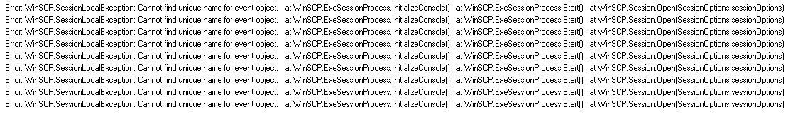

I got message Cannot find unique name for event object.

I use WinSCP.NET assembly and i try connect synchonize SFTP multi thread. i got message some thread when connect SFTP.

I want to use about 100 threads.

Download WinSCP .NET assembly source code and modify the ExeSessionProcess.InitializeConsole() to reduce chance of this happening. You can increase MaxAttempts or possibly add object's hash code to _instanceName.
I'll improve this in the next release.
