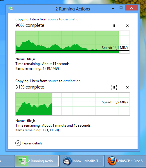

Regarding your reference to Windows progress bar: It's not really a fair comparison as Windows 7 does not have a queue of transfers. It's displaying progress of single transfer only (equivalent to single line in WinSCP queue). When Windows shows single progress for multiple parallel transfers (Windows does that when its groups multiple buttons into one, when taskbar becomes crowded; Windows 8 does this always), it's not doing any good job as it shows progress of the least "progressed" transfer only (see attached Windows 8 screenshot). I believe this is not what you seek for.
Well, to be honest, I'm already happy that WinSCP *does* show a progress bar on the task bar icon at all, because FileZilla suffers from not having this feature:
https://trac.filezilla-project.org/ticket/2086
And I guess you're right, I never realized that windows only reflect the progress of one task. From my experience, in most cases it doesn't make a big difference though, because if you split an upload into several equal parts, they will take a fairly similar amount of upload time. Of course, that may be differ for users with other requirements.
