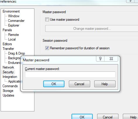

Greetings,
Even though my master password is disabled WinSCP asks for it every time I try to load a session. Nothing I enter works so it appears all my saved logins are gone. :<

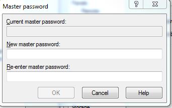

Earlier I changed my master password then disabled it. I cannot re-enable the master password no matter what I try. When I try to re-enable the master password, WinSCP has the master password field disabled on the new master password creation dialog (see first attached image below).

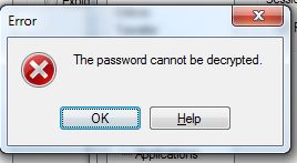

But then strangely it brings up a new prompt asking for the master password. Entering the old combinations give "you did not enter the correct master password" and entering the new master password just created gives the error "password cannot be decrypted" (see second attached image below).

Also would be nice if I could get rid of the constant master password prompt somehow without starting over with a fresh ini (it's disabled but I still get the prompt). Tried upgrading to the latest beta version and that didn't have any effect.
Description: Note unchecked "use master password" but still getting prompts for the master password.
Re: Master password bugged "Password cannot be decrypted"
This can happen, when you enable master password, but then WinSCP is not properly closed (like when the process is killed or crashes, or when machine is not shut down cleanly). Or possibly if you have more instances of WinSCP running at the same time when setting/clearing master password.
I'll see if I can do something for you. Will contact you, once I have anything to try.
I think that was it. I usually have multiple instances open at once (at least I did before I just upgraded to the latest beta). Thank you very much for looking into this and all your hard work!
ahisma
Got it, thanks! Unfortunately still get the "password cannot be decrypted" error when trying all old iterations of the master password. No worries as I've already reset most of the logins I regularly use anyways.
