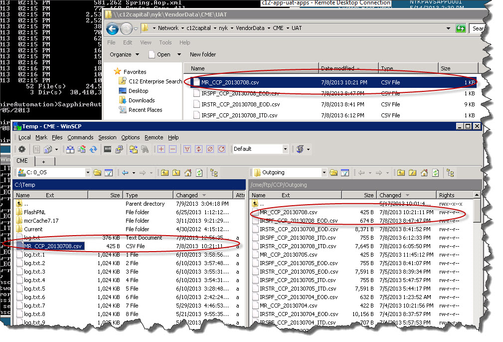

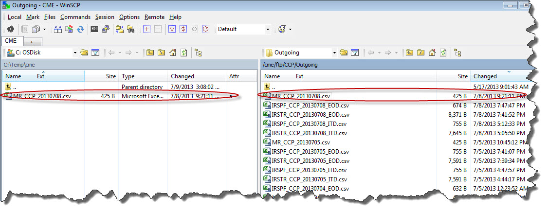

Our servers/workstations are in EST. The remote server is CMT (i.e. 1 hour behind EST). On our server the WinSCP GUI should the time of the file on the remote server to be one hour ahead. My workstation shows the correct time.
If I change the DST settings in Environment in the WinSCP GUI on our server, the time on the remote server displays correctly. But in the code, the file is always downloaded with the time being 1 hour ahead.
I have attached 2 screenshots. One from our server showing the WinSCP GUI and in the background the file downloaded from the code. And the second screenshot shows my workstation and WinSCP and the correct time.
