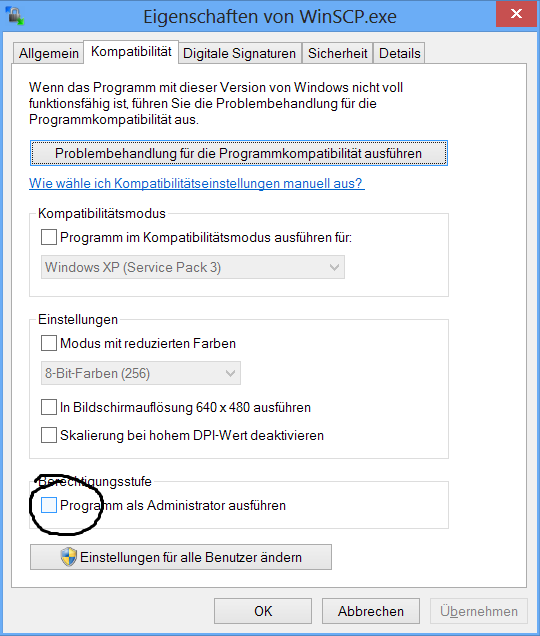

Re: Admin rights
mstra001 wrote:
On my system (Win8) the drag & drop stopped working when I used admin rights for the program.
But that's with any application running as administrator (try it with Microsoft Word for instance). Seems to be prevented by Windows/Windows Explorer.
